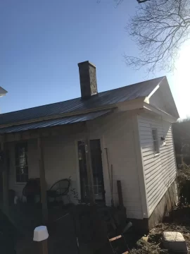

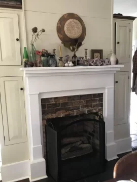

My husband and I recently decided to convert one of our gas fireplaces to wood, as we have six acres of woods and plenty of access to firewood. We figured we would have a professional line our chimney and possibly also install a wood stove, or maybe tackle the installing of a wood stove ourselves if it seemed pretty straightforward. I called around to numerous chimney are fireplace specialists, but we were out of their range (In the Piedmont of NC, but fairly rural area). We settled on a general contractor to come out and give us a quote on the job. it is a one story existing masonry chimney. He measured the chimney but did not remove the metal plate covering it's opening above the gas logs, nor did he get on the roof and look down the chimney. He gave us a quote of $3860 to line the chimney with a 6" metal pipe and install a wood stove for us. He also made it clear he would have to get on the roof and inspect the chimney first, and $3860 is if no issues were found. I am a bit taken aback at the price, as my husband and I had our chimney lined in our old home in Pittsburgh, PA that was two stories, needed an extender and a cap, and included a much nicer liner with a lifetime warranty for $2400 (about 4 years ago). If this is the going rate I think we will either have to try to do it ourselves or give up. I suspect this is an extremely high quote though and maybe I should keep looking for a contractor willing to do it. Any thoughts? Anyone do this work in the Piedmont of NC?

View attachment 270670 View attachment 270671
That does sound a bit high. Installing the liner may be simple or may not be there are many variables.

It appears the woodwork might be too close to a stove. Be careful with clearance to combustibles!
