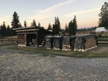

A double row is 32” on top and the plastic comes in a 20’ wide roll. I cut it in half the long way, fold it over so it’s double thick, and that gets me a 5’ wide sheet. That means in a perfect world, 14” of overhang.
I use masons twine back and forth over the top stapled to the wood to hold down the plastic.
I’ve done it this way for the last 12 years and finally built a woodshed this year. The black 6 mil poly would make it 4 years. Two layers are good. The wood gets wet on the sides, not just a little wet. I also acquired some sheet metal roofing and that overhang keeps the wood much drier.

I do the same thing. I’ve found the plastic works quite well. I like it much better than tarps.
I wish I had the same good luck with HD 6 MIL plastic. Even in my shady area the sun disintigrates it after a couple years.
The more expensive heavy Brown tarps from TarpsDirect last for years and years.

Great place to dry wood. Mine is cleared space in woods. Lot of damn fungi this year
Reactions: Highbeam
Ya not sure why but despite how reasonably dry it was this year, I have mushrooms of all kinds growing all over my lawn right now. It's been a while since I mowed & might not now till next year, but I haven't seen shrooms like this before.
