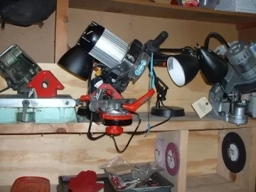

You could get some grinder(s) From left to right, rakers, .325 and 3/8th/.404 grinders

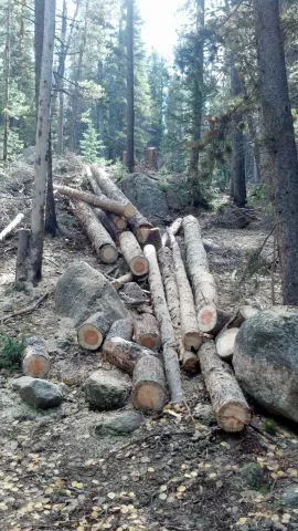

While bucking up my landing logs today, I whacked a (definitely unseen) pointy piece of granite sticking up between two of the smaller logs a the bottom of the photo. Instantly screwed! Thank goodness for the old spare chain. I had been following the practice of dressing it up after every couple of tanks. Now I'll be spending some time in he garage trueing things up with the Granberg guide.
That's only about the second time in three years I've been bit. The first, an old power line lag screw and glass insulator was completely grown into a log. No chance I ever saw that one. That chain has never cut quite right since.
