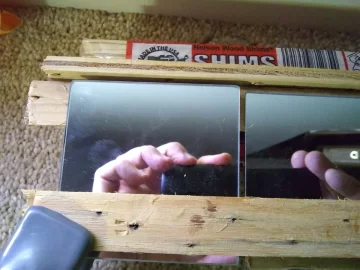

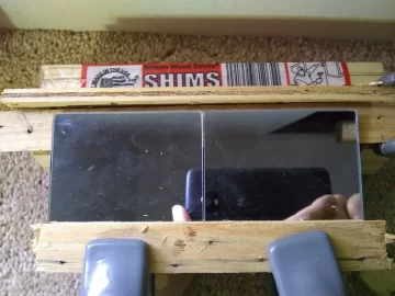

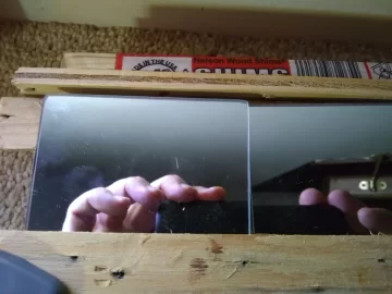

Include are some pictures I made to mimic what I saw. Two pieces of glass represent the top of the doors when they swing closed, and some scrap wood to represents the frame. One of the pics is in perfect alignment, what I want but not what I saw in any of the three shops I want to.
Two pics represent what I saw in every sample I looked at and played with by opening and closing the doors. In fact my pics under estimate how much some of the models were misaligned.
