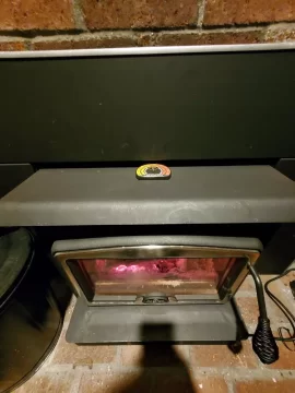

Do I go by stovetop temp? I don't have a pipe or flue thermometer as its an insert but my insert does protrude quite a bit due to the masonry. My stove top thermometer is pretty close to the middle of the unit.

I think the "stove top" for this insert is actually the top of the convection jacket. Is there an airspace under the top of the stove from which the hot air blows out? If yes, then putting a thermometer on the stove face above the door corner will give a more accurate reading. Yes, go by stove temp, but also the fire itself.

I think its the actual stovetop. The air comes from the gap between the facing and the stovetop so the jacket sits behind the facing.

Great. If that is the case then you're fine with that location.
