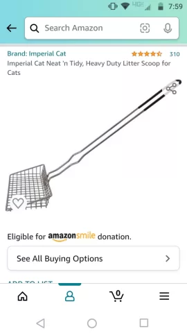

I bought this thing over the summer. Allows to scoop only the coals to one side. Quite a few reviews there say they use it in stoves etc
