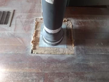

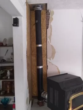

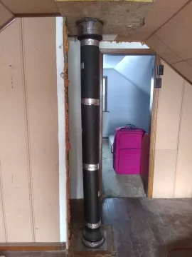

Here's my ugly stove pipe. You can see the old footprint of the brick chimney that used to be there.
The house is very old and was added on to and modified several times waaay before I got my hands on it in 2006. Moved it to new foundation in 2008.

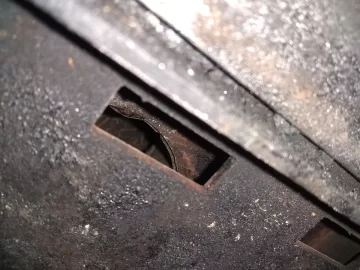

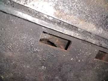

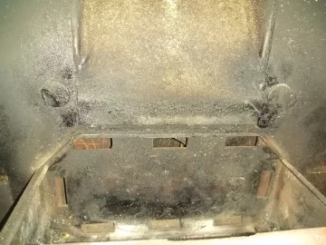

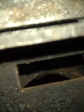

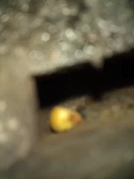

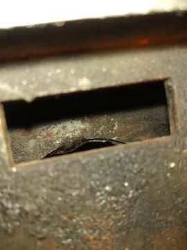

I can see the exhaust tube, if that's behind the burnpot.
It was hard to capture with my phone, but I could see back in there some. None of that hard stuff right there. But I did find a corn.

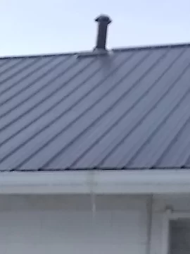

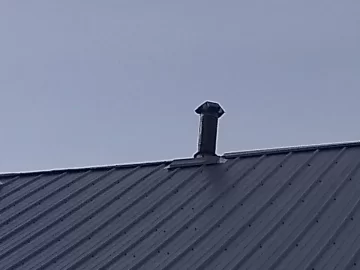

Oh, I also found binoculars. I cant see inside the cap, of course, but I was able to see more creosote drippings leaking out at the seams. Id like to fire it up again and look for smoke with the binoculars.
Also, I would REALLY hate to do it. It would be a horrible mess. But if it were blocked in the cap I could always disconnect it upstairs and shove a coat hanger up inside to the cap. It's just such a messy pain to play with that sooty stove pipe that doesnt always want to go back together easily.

I actually did get a few better angles of it. I dont know if it tells you anything you didnt already know.

I was wrong. That isnt creosote drippings I'm seeing on the roof. That was black roofing sealer stuff my husband went crazy with when we were trying to seal up leaks when the roof still leaked.
