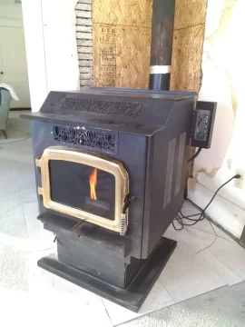

That is the intake air adding air into the burn pot. No blockage there. The exhaust side is the side that is f'd up:eek:

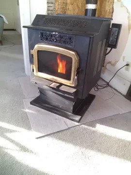

Update: I fired it up again. This time my stove pip DID get warm. Not hot, just warm. And I could see smoke coming out the cap outside.
Maybe that creosote shot did something last night?

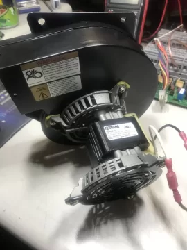

3: Removed and cleaned the combustion blower and upgraded paddle fan blade.

I trying one more time. This time I left the little metal doors to ash clean outs off hoping more air would get through?

How did that go?
Reactions: Ssyko
You are a wonderful person....
I want to see this stove burn, and then we can decide if its a keeper and gets new convection blower

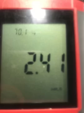

She tried the leaf blower and absolutely nothing came out except clear air. That tells me what was loose ash that caused the stove to shut down originally has been turned into a hardened mess when the previous guy decided to jump the vac switch and force it to keep going. He ran it plugged with the switch jumped until it creosoted up to the point it would not sustain a fire. Then sold it! 30 seconds with a leaf blower when it shut originally and the stove would have still been golden. I have serviced many of these stoves and if it shuts down on a low vac error, I brush ash traps out, Brush vent pipe then open the front door and suck it out w/ leaf blower. Vac goes from a .05 or so to .3 inwc where it belongs. It only needs .1 inwc to close the switch so if it shuts down it is pretty plugged
