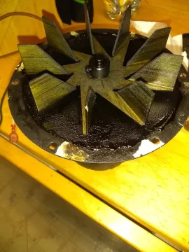

I need this now sticky icky plate off of this motor, right?
Anyone know how to get this stuff out of carpet?
  • [Hearth.com] How to burn wood pellets in 2006 Auburn corn burner
A degreaser will pull most of it out, hopefully it’s not a light color
Of course it is! Powder blue!
I could just throttle that guy at this point.
Fricka fracking burnt wet corn shiat all over my F*#cking rug. Grrrrrrr.:mad:
I was really hoping to put the new fan motor on tonight. There's no way. I'm going to have to scrape g©d d@mned black goo off everything first and try not to get it smeared anywhere else.

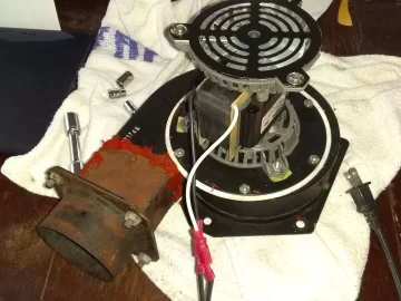

Remove the fan and use a putty knife, easy-peasy
Reactions: Rxwoman1961
Yes, thank you.

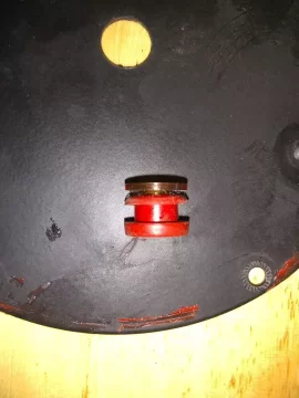

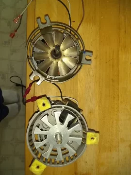

Ssyko, new problem. The mount bolt thingys dont quite fit. How can I fix this. ..or can I?
See on the pics, the 3 holes are really big on the old one ( top pic) and it had 1 of those red rubber gasket looking things on each bolt to keep it tight.
[Hearth.com] How to burn wood pellets in 2006 Auburn corn burner [Hearth.com] How to burn wood pellets in 2006 Auburn corn burner [Hearth.com] How to burn wood pellets in 2006 Auburn corn burner
Those rubber gaskets are for motor vibration isolation from the mounting I believe. I have them on my Harman. Hope Ssyko chimes in soon, I don't want to give you wrong advice.., but once the rubber things are in the old slots then the hole is smaller for the bolts., correct ?? Do the mounting bolts fit in the replacement motor holes ??
Put the motor on the plate its a tight fit but it will go. Drill the holes bigger on the motor if need be. We aren’t worried about noise at this point. We gonna have air
(bet it’s still quieter than the convection blower lol)
Nope. 2 holes will almost go, but it always leaves #3 off.
I'm going to have to gouge one hole a little bigger to make it fit. Surely one of the bits in the Ryobi set is for metal.
And I have to work this eve so tomorrow before I can get to it.
Reactions: gfreek and Ssyko
Let it rip drill all 3 hole bigger might give ya more room
Reactions: Washed-Up
Dont try to put the red rubber isolators on just get the studs up through the motor mounts.

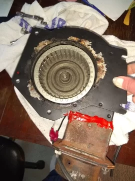

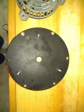

Ok, while I'm waiting for the red gasket goo to set up a bit, here's what I have.
I even had a fiberglass gasket for fan as I sent for a replecement way back before knowing about the tuba stuff.
In reality the gasket is a better deal. I would have used it instead. Only reason we use red glue is we are too cheap to buy replacement gaskets....lol
