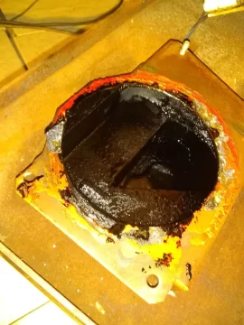

Ok Ssyko, so I'm disconnecting the stove from pipe again, and removing the whole motor and part that connects to the stove pipe, what did you call that? And taking the fan blade I just replaced off, and this time the motor too. and putting both back on the metal tube part that hooks to the stove pipe. Is that about right?
yep that’s exactly what to do. The new squirrel cage fan uses a T15 torx bit to tighten it on the shaft. Also the shaft and hub of the fan should be flush when you tighten it.
