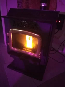

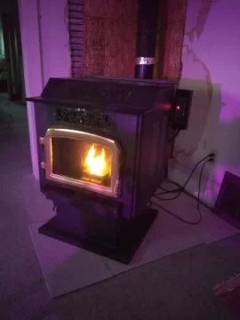

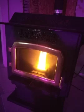

Does this fire look better (They all look the same to me) ?
  • [Hearth.com] How to burn wood pellets in 2006 Auburn corn burner
best i've seen yet out of that thing :)
is the damper wide open?
Reactions: Rxwoman1961
Looked at some of the previous pics and looks better , IMO...
Where is your outlet surge suppressor??? No point in roasting the board now....
if it cooks ill fix it. i just wonder how much noise that convection blower is gonna make :p
