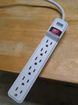

Where is your outlet surge suppressor??? No point in roasting the board now....
What's a surge suppressor? One of these?
Ah, no. That is an outlet strip, not a surge suppressor, but I figure 'Santa Ssyko' will address everything in good time.

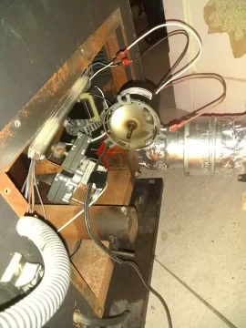

hook your old blower motor up to the wires next to the stove and just let it run along with everything else and see what it does. new pics of flame. im wondering if its burning out faster than it can feed them put it up on 4 for a bit
Biting my nails to the cuticles...pretty stoked to see it at this point, just got home from work and checked this first ;)
I couldn't get to the damn wires without taking damn back off again as they are too short.
What a mess. But, ya the control panel behaves like it did before with the old fan motor hooked up.
But I can't leave like that.
