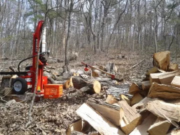

If you have a slope, someone on here (BBart?) showed a pic that got me going. Line the rounds up uphill and let them come to you. Any woods tree i cut on my hillside, or pickup load of big stuff, gets done this way now if possible. her's a pic from a few oaks I did this way
My backyard has a slight slope that I take full advantage of. Logs get delivered on the high side and the stacks are on the low side. It is real nice having a 24" round roll clear across the yard from a firm push with the boot and a few taps as it rolls to keep it on course.
