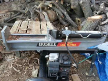

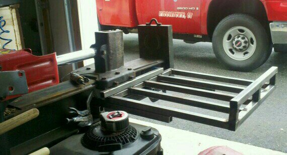

My buddy made me a table for my splitter...as someone else said, it saves a lot of time.
[Hearth.com] How to increase splitting speed & efficiency?
In case you can't weld. Works great and very portable.

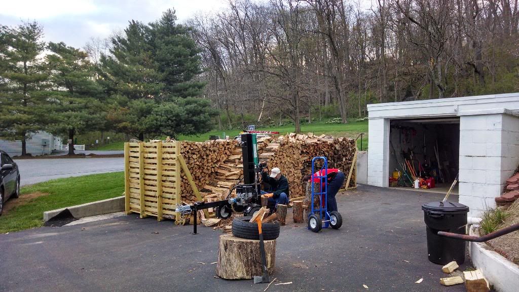

Get a 4 way wedge and put that on the huskey . Once you do you will kick yourself so many times over on why you have not done that before . With a good helper on the timberwolf I can split a full cord an hour ,provided they can keep up throwing the wood off the delivery table . A 4way wedge on there will speed you up 3 or more times as fast and save your back .
have a friend run the maul while you run the machine.........
Last night in about 2hrs my father in law and i made about a cord. He ran the machine with the bigger and knarlyer( spelling?) splits, and i ran the fiskars with the tire trick. I was pumpin out as much wood as he was. sometimes more. Put 2-3 smaller rounds in a tire on top of your splitting block, whack whack whack....... stack stack stack.
