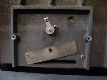

I like the look of that VC insert. The cat and thermostat are just what I need for my low heat requirements. I'd love to be able to burn with the firebox interior down at 500ºF, instead of 1100ºF or smoke. At the moment we are just having one tiny fire every evening. Four hours later the stove is just warm to touch, but the house is about 78ºF (50ºF outside). A cat would let me burn longer and cooler I think.

Two thermostats in fact -- one for primary air, one for secondary air which enters just upstream from the cat. See photo attached of back of insert. Copper probe from center of thermostat coil extends thru stove back into secondary combustion chamber into the exhaust stream 1" downstream from catalytic combustor.
It works remarkably well for a 15 year old stove now that I have regasketed it and replaced a few parts, this secondary thermostat and probe included.
It was 48* F here last night. I burned a medium output fire from three Maple splits that lasted 7 hours, left about a pint of charcoal and a pint of very fine white ash.
