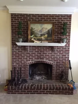

I am in the process of choosing an insert for my fireplace and so far, it looks like the Enviro Boston 1700 is the winner.

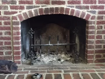

The problem I see getting this insert installed is that my fireplace opening is arched, and the bricks around the arch protrude about 3/4 of an inch from the wall which will prevent the surround from fitting flush with my fireplace.
I would like for this insert and surround to sit flush with the fireplace so I was wondering what could be done to avoid altering the bricks that are currently in place.
Any suggestions?

You either have to modify the brick or the surround is probably a much better option

I am leaning more towards modifying the surround as i would hate to tear up the bricks. According to Enviro, the Boston surround is 30.75 inches tall, and the highest part of my arch is 30.5, so it would be cutting it really close if I were to alter the brick. Width wise I have plenty of room. It seems like I would need to create some kind of backing plate that the surround would mount to, however I am not sure how good that would look.

You could go to your local metalworks shop and ask if they can make a custom surround for your fireplace that fits the arch. Maybe Enviro will give you a little rebate when not ordering the surround with the rest.

I would try the metal shop route. See if they can make a backer plate with a return that can sit over the brick and give the surround something flat to rest on.

I took some more measurements last night and made a template of the surround based on Enviro's numbers, at it looks like the top of the surround will be just a bit short, even if I shave the bricks. That said, I am thinking of constructing a C shaped frame out of 1.5 x 3/4 inch thick rectangular steel stock. The frame would rest over the arch and would extend down the sides. Seeing that it is 3/4 thick, it would sit flush with the bricks that stick out and provide a flush base for the surround to slide against. I can do the welding myself and have the welding equipment on hand, and the metal would be cheap so I would only need to paint it flat black with high temp paint and I believe I should be good to go.

I was told the same thing in regards to it being common. Funny thing is I have spoken with 2 installers and one said shave the bricks and the other said to do it only as a last resort. Seeing that I would rather preserve the fireplace as is, I am leaning towards a custom surround. I have a tig and mig welder, so I may as well put them to work.

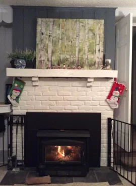

Dano, something worth mentioning. I keep my surround about 3/4" off of the brick on my fireplace. I like to allow whatever heat is trapped inside the fireplace to flow out into the room. It's hardly noticeable. This was from Christmas. The unit you are buying has a much nicer surround.

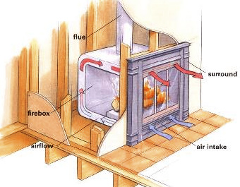

The problem is not just the draft of the fireplace but whether it was installed safely or not. Around the firebox should be an additional steel box with an airspace between the two. Through vents often on the bottom and the top air can move between those two boxes to keep the outside cool. See this scheme:

That cooling effect makes it possible to install the unit with "zero clearance". Maybe yours has those vents in a different location (sometimes connected to the outside) but without knowing the model and having a manual it is hard to say.
