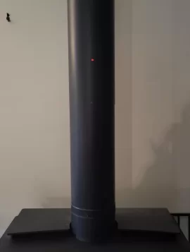

The wife was gracious about taking a pic while I was at work.
My chimney pipe inside is a double wall telescoping uninsulated seen here. To clean, the plan was to disconnect from the stove and the first connection and simply slide the pipe "up" into itself until both pieces are flush and then go straight up.
My question now I guess is 3 fold.
I assume where the red dot is is approximately where I should put the thermometer. Theres nothing mentioned in the manual about it, so I'd be just guessing. Alternatively I was half tempted to just take that front screw out and drill it all the way through for the probe, which may be acceptable, I truly don't know.
Its simply a matter of drilling a hole through both pieces of steel, and it'll go through both layers and stick on magnetically, correct?
As long as I remove the thermometer beforehand (obviously), it shouldn't interfere with collapsing of the pipe to clean it I hope?
Any risk of creosote build up inside the layers between the pipes through the hole? The gap between the hole created by the drill bit and probe should be as tight as possible, but I'm not sure how dirty these units get. I assume I won't get 5 gallons of mixed creosote in a bucket after each heating season like I used to (I had an external clay lined 30' masonry chimney and pre EPA basement unit, about the worst on efficiency and creosote building as one could possibly get) but I don't want to cause myself to replace this pipe section either or cause a creosote fire between layers of pipe 10 years from now either.

I have a similar setup with telescoping pipe and I drilled my hole for my probe into the lower pipe that slides up a few inches below the screws. If you drill above those screws where that red dot is you may have trouble lining the hole back up after sweeping.
Thank you! Little tricks like this are extremely helpful. I was worried if I did it on the lower half of the tube, I'd have the same issue you thought I'd have on the upper, that's why I figured I had to put it higher up. I'll probably order one this weekend. I'm having elbow surgery Friday due to a firewood related injury, so it'll give me something to do next week while I recover assuming I can use my elbow as well as they claim I'll be able to after. Lol.
