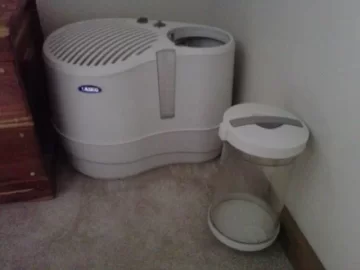

I have the Lasko 1128. I think its a good unit. Has a removable Quick fill resivoir that holds 1.5 gallons. The bottom of the unit holds 3 gallons. So you could have a total of 4.5 in the unit. It will emit 9 gallons in 24 hrs. But you have to keep it full. We leave it on Low while we sleep and are at work and High when we are at home (up and about). Keeps the house around 45% humidity. Which feels much nicer than the 20% it was before we got it. No a really high tech unit. But it gets the job done. About $90 at Menards. Took the removable fill jug out, to show it in the pic.

Dexterday,
Is the refill canister easy to refill? It looks a little long. Will it fit in a kitchen sink easily? How often do you have to replace your filter/wick? Thanks
Flynfrfun
flynfrfun said:
Dexterday,
Flynfrfun
If you have tall kitchen sink or a sprayer nozzle on your sink, it shouldn't be a problem. I have bothand I still use my bathtub. It is a little tall. Just measured to give a number to check your sinks. Its 13.5" from top to bottom of jug. The fill is on the bottom of jug. Has a good seal on it and a handle to carry once you get it filled. Around 13 lbs full of water. Clean filter throughout heating season in a 1 part vinegar to 4 parts water solution per owners manual. Buy a new filter every year. (Could prob make it 2-3 yrs)

Thanks...yes, we have a sprayer nozzle as well as a deep well sink. So 13" shouldn't be a problem. My humidifier will have to be located downstairs where we don't have a tub, so I'll have to fill from the kitchen sink. Is the noise really that bad? I figure if I get this model, I'll leave it on speed 1 and just let it run there.
Flynfrfun
On speed 2 or 3 it is a little loud. But speed 1 is quiet. Says in the manual, that this is "sleep mode" or "quiet operation". We do have a Humidistat. Because this does not have digital humidity read-out. Although this model will turn off and on with the humidity dial. We run ours constantly as stated above. High when home and awake. Low while slleping and working. So you leaving it on low should work fine. No more static, cracked hands, bleeding noses (wife is pregnant), etc. The one imacman posted is a good one also. We looked at it. Would have looked better in the room. But we got what we got and I am quite happy with it. Good luck on your purchase. With any kind of stove you have to humidify the DRY air. Whatever you choose as long as its big enough to fit your needs. (Our house is a 2,180 sq ft ranch)
