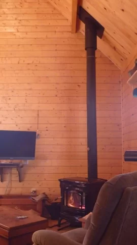

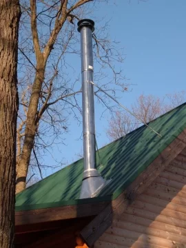

Here's a photo of mine, inside and out. Single-wall in, double-wall insulated out. The roof is just 2" pine with sheet-foam insulation and metal sheathing over that. I clean from below so I don't have to try to reach top of chimney with a ladder on the sloped roof.
[Hearth.com] Hunting Shack stove help needed [Hearth.com] Hunting Shack stove help needed
Yes something simple like that is what we're trying to do. Although we'd have to go through a floor first. But it sounds like it's hard to do for under $1000
In order to stay under $1000 you would have to get a very good deal on everything used. And even then you would have to orderr some parts for the chimney i am sure. I seriously doubt you will be able to do it

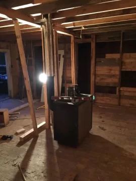

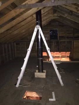

Well my grandpa picked up a stove he deemed was good and we picked up 16+ ft of double insulated pipe, support pieces, storm collar and flashing, and cap. All stainless steel duravent pieces I believe. Came with a couple of the 45 degree swivel connecting pieces as well.
We'll see how this turns out. Got everything but the stove for $250. We didn't get everything done, but got it all in place and holes in the ceilings and walls. Still need something under eat the stove.
Appreciate all the tips and help. Should be a good heater once we get it all done
