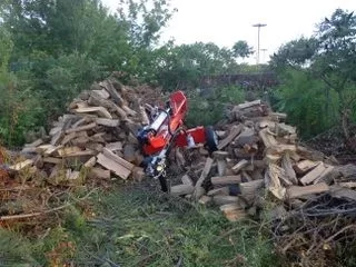

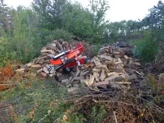

[Hearth.com] Husky 22 ton[Hearth.com] Husky 22 ton
Wood on either side of the splitter is what I accomplished today. This little splitter had no problems with all but one knotted twisted up piece that can be sawed up more. I am quite pleased with the Huskee 22 ton. A good bang for your buck.

Very nice pics. Glad to hear your happy with the husky. Looks like some technical splitting. Nice size pile! Life is good
