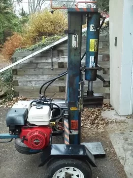

As far as I can see there is no such mechanism on this machine.

What's that thing protruding out from the cylinder just abovethe bottom of the cylinder and below the bracket?
EDIT: That's the hydraulic hose.

Must have another way of "knowing" how much travel there should be and when to cut in and out.
It "knows" where to stop inside the valve. On the return stroke when the ram reaches the end it builds pressure and kicks out the detent. Is your new suction line collapsing?? Sometimes they will not show on the exterior but the inside will collapse. You may have to tee a gauge in to see what's going on.
