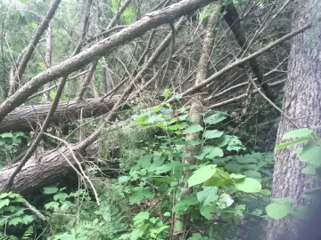

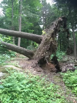

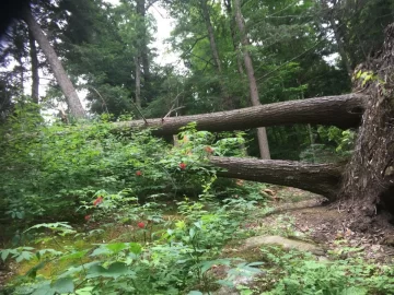

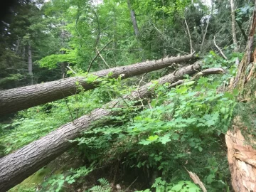

[Hearth.com] I am already three years ahead and now this.... [Hearth.com] I am already three years ahead and now this.... [Hearth.com] I am already three years ahead and now this....
And some more pics

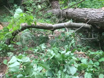

[Hearth.com] I am already three years ahead and now this.... Started limbing

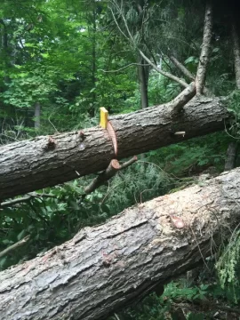

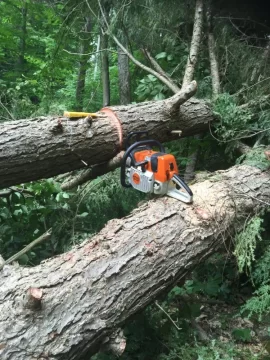

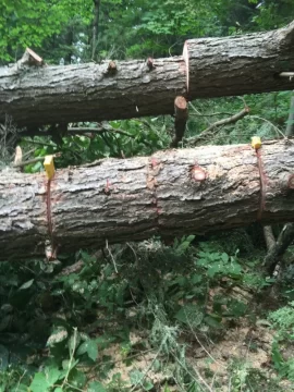

[Hearth.com] I am already three years ahead and now this.... And cutting. Rooky mistake! A pinch on a first cut

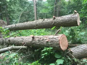

The crown was held up on the bottom branches and the uphill. Eventually the cut sections dropped and I started working my way down, both trunks

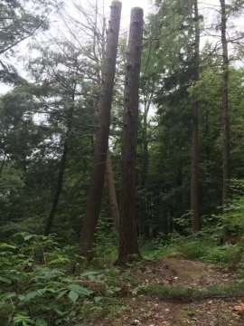

[Hearth.com] I am already three years ahead and now this.... Five minutes later....

I had to head back to town. Will take the trunks down next time.

That's crazy that both trees went down like that but I find it funny they stood back up just the same.
Good job being safe with it.
Nice work and beautiful woods - jealous of the hardwood and wish we had some around here. Glad you got that done safely - had to be a little bit of pucker factor because that is a lot of weight!
Reactions: Diabel
Are those white (female) gypsy moths on the base of the tree trunk on the left ?
Double blow-down! Wow. Is it hung up in other trees? If not, I'd probably start taking material off the tops of both trees working down toward the roots. Clearing limbs first then bucking the trunk in 5' sections. If it wants to go back to vertical you'll start to see that gradually as you work toward your way to the base. Also, you'll be working clear of most of the reach of the trees should any movement be a concern .
I've cut literally 40+ cords of blow-down from super-storm Sandy, almost all stuff 2x - 3x larger than this. Going top-down always sounds good on paper, but it's not really practical. I'd be doing it exactly as Jags describes.
Remember, there's no shame in using your pole saw for the first trunk cut, if it has enough bar to make it from both sides. It keeps me 12 feet away from any surprises or shifts, although I don't see that being a huge issue here.
If it begins to stand up during the first cut, get on the throttle and finish the cut fast. They don't stand up very fast with that sort of weight cantilevered out there, and hesitating or backing away will leave you with an unbelievable dangerous mess on your hands, DAMHIKT.
It always helps having a spotter with cool nerves, to flag you if something really doesn't look good. For example, not my wife, who would be screaming at the first inconsequential shift.

These two are hemlocks (pine family I believe). Not the best wood for burning in the dead of winter, but it does fine in the fall/spring burning. I do have lots of soft/hard maple, beech and yellow birch on this property.
No, I don't think I noticed any moths. The only things flying around were wood chips from my saw.

I did want to use Jag's approach, but in the end I figured, either way the stuff needs to be bucked and split. I am not sure if Jag's way would save any time.

So when the tree trunks stood back up was it a slow movement vertically or fast?
Slow. You really notice whey it starts to stand up. Plenty of time to step away.
That is why starting from the crown down is the safest in my opinion. I consider myself a rooky in this field, always will be since I cut maybe three to four trees a year.

Bottom first . . . and I would personally work it slowly from the top . . . since there is a chance that as weight is removed from the bottom tree being cut that the top tree and root ball could slowly (or quickly) pop back up to the "standing tree position" (new yoga position). As mentioned, cutting the bottom tree would also get everything out of the way so no hang ups.
In any case, just be very careful . . . plan your work . . . keep stepping back to analyze everything and be prepared for movement.
I am with you. I would work it from the top of the tree back to the base. My log lengths I cut to are 18". So I would start on the bottom one, take 18" off then take 18" off the top one, then 18" off the bottom and alternate back and forth a little at a time occasionally turning my saw off and setting it down to see if I would feel the trunk and when equilibrium is being approached and if it was about to snap back up. Just stand clear as you cut in case it does snap back. Err on the side of caution because this has the potential to cause nasty injuries. Take your time, think it through and don't rush. I am not a professional but that's what I would do.

That just looks funny! If it were me I'd leave them there just like that for long enough to get a few quizzical glances from friends and family. I could hear my FIL now, "I don't get it. Why... why would you climb..."
Amazing they way they stand up. I never would have imagined that. I've never cut blow down.

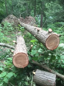

Almost done.
The fun part is over!!
