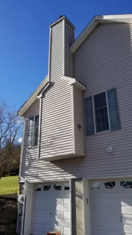

Is like to see your chimney on the out side. There are certain dimensions and clearances that need to be maintained. Thinking maybe its to short. Also see if there is an internal damper that could be closed. I guess if you have had a sweep out there that part must be OK. So maybe post a photo of what I ask you to
Thank you outside picture posted, hope this helps.

thats a good idea, your chimney appears to be high enough and far enough away from roof lines

Looking at your outside chimney check that little box vent and make sure it isn't plugged, looks like some type outside air connection.
