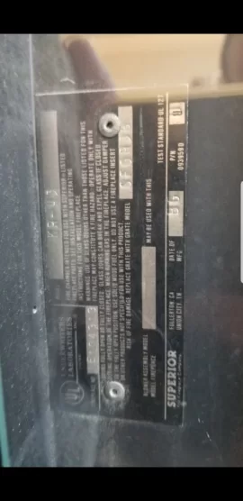

Kenny I was told by Lopi and my local lopi dealer that their insert can safely be installed in my zero clearance fireplace as well as a few other models and brands. I have had other places tell me it's not safe and should not be done which makes me hesitant but I would assume lopi did testing and designed them to be safe if that's what they advertise?

Without a manual there is no way to know if an insert is permitted
As I mentioned earlier a local lopi dealer came here to inspect and give an estimate and he said it is ok for the lopi unit and I contacted lopi directly and sent them the info and they confirmed it to be safe so I feel comfortable with it. I was also told the Regency unit would work as well. Picture is attached below.
Did they not bother to even read the I'd tag. It clearly says no inserts.
