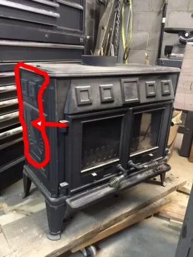

Hi. My in-laws have moved to gas, and gave us an old but excellent condition stove. Dovre 300E 60,000 btu’s.
We have 1300sf with a full basement (2600 total but the basement is unheated). There’s a ~200sf den in the basement with a fireplace. We rarely use this room. The fireplace is brick masonry all the way up with a steel lining. The fireplace opening is about 4 inches wider, and 4 inches higher than the stove, fairly close fit.
We use the room to watch a movie, or do a bit of computer work. We might be in there 3 hours at a time. The fireplace is useless. Won’t hardly warm the room in that amount of time, and we’re nervous about leaving it. So we usually just run a space heater.
Obviously, this wood stove is too much stove for the room, and maybe too big for the fireplace opening. But would it work okay for how we would use it? We would probably start a fire, watch a movie, and let it go out, safely contained in the wood stove so we could leave the room. I also wonder about using it to heat other parts of the house. A pass through vent through the ceiling of that room would put heat into the dining room/kitchen part of the house. I’m not sure how effective that would be. We’ve also thought about taking out a 10’ section of wall, which might allow heat from this wood stove to heat other parts of the basement, which is where I work, and go up the stairs to the rest of the house. These are appealing possibilities, since we heat with oil!
I would appreciate any words of wisdom. Installing the liner will involve dismantling the damper. path of no return. If this is a bad idea, I could see selling it and buying something smaller. One question I have is whether you can maintain a small fire in a larger stove?

I would have the stove checked out by someone qualified to do so, it shows signs of having a hard life (over firing).
I was thinking the same. The Dovre 300 is a serious heater but eventually, parts can fail. Typically this will be in the secondary burn area with a turbulator or air injector burnout. This location should be examined.

I don't know if the E has the cat option on it or not, if the OP could get pictures posted of the inside of the stove that would be helpful.
I was wondering the same thing. There is the 300H and 300HC where the C indicates the catalyst model. Maybe the 300-E is the Eco version?? I don't think it's an electric model. ;lol

I should mention the stove was being stored in my woodworking shop, protected by layer of saw dust. Perhaps that has given it the appearance of a lot of use. I don’t see any evidence of over firing on the inside. Nothing warped. No rust. Maybe the white seals were replaced, but they look good as well, still mostly white. This was in the finished basement of someone’s mountain vacation home, with central heat.
Not sure what the E is for. Nothing about it in the owners manual. There’s no catalyst in this one.

Looks like a great stove to me. Free? Thats awesome. I know itll cost ya to put it in, but hey, youre ahead of the game. My stove was really cheap, free.....I traded for it. No cash exchanged. My friend didnt need it anymore. He wanted 300 for it, so I guess thats what I paid. Your stove looks sweet.....pretty big huh?
