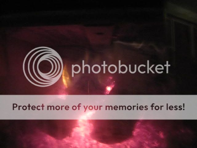

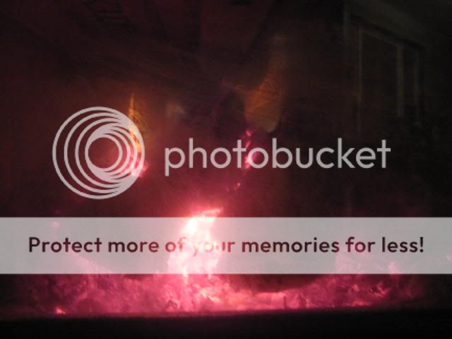

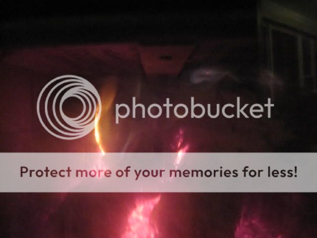

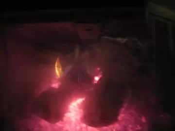

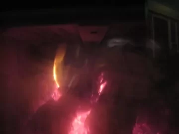

Ok, im not sure this is going to help at all, but i took some pictures of the stove just a few minutes ago. Glass is dirty and pics are a bit grainy (hey, its not like i planned on taking pics of my stove today :red: ), but i hope you can see the colour of the flames and how they are rolling under the baffles. and maybe determine something. That looks like good secondary burn, at least to my uneducated eyes.
Stove was loaded 2 hours or so, maybe 2.5
Damper is on ~1/4 +
pipe temp 300*
Stove top temp 485*
