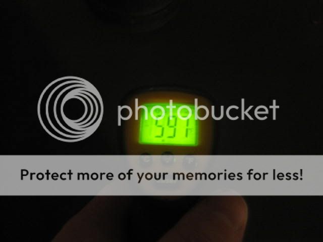

		![[Hearth.com] I hate my Napoleon 1450... suggestions for replacement [Hearth.com] I hate my Napoleon 1450... suggestions for replacement](/talk/proxy.php?image=http%3A%2F%2Fi650.photobucket.com%2Falbums%2Fuu221%2Fscooby074%2FWood_Stove%2FIMG_3674.jpg&hash=06c1f088fce8c8b095343401f43714b6)
