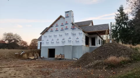

Interesting thread and relevant to my interests. We're in the middle of a house build and doing pretty much the same thing; a stove on the first floor and a stove right below it in the basement, chimney pipes sharing the same chase. The basement run will be over 30' high, and probably somewhere around 20' for the first floor.
ETA: Much lower elevation here, around 1100' ASL.

Yep, both stoves are going to be on outside walls. Already ordered the first floor stove (Lopi Endeavor) with an outside air kit. The basement stove, I was thinking OAK also. Hoping I can run it up and out at the first floor level so I don't have to punch a hole though the concrete basement (see pic below).
Nope, the outside air must be at or below the stove's firebox floor to prevent the possibility of reverse draft and the OAK acting as a chimney. A hole should be cut for each stove.
A radon fan may end up being a source of negative pressure in the basement. Will there be an HRV or ERV supplying warmed, fresh makeup air to the basement? That will help.
