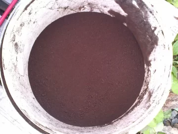

Hey guys
I swept today. I figured it was time to get it done since I had not swept since last summer. Not to mention my 3 year old was visiting his grandparents for a few hours so I could get some work done without running after my tools (not to mention the mess he would get in with the soot..he sticks to me like glue when I am out and about in the yard).
Here are some pics of the sweep...it is only my second time sweeping so I am slowly getting into a smart process (systematic). I still did go inside/outside 12 times or so since I would forget a tool, screws, shop vac, etc.
I figure I got about 1/2 to 2/3 of a gallon on a 20 foot class A Chimney setup. Fluffy, brown and dry. That's a good thing right?
Ready to burn for another year! yay.

The color is spot on. A tiny bit more than I'd expect, but I wouldn't complain a bit.
If that's how much you had stuck in there, and the cap was not plugged or anything, then I'd say you are on a good schedule, especially if this is the second year with similar results.

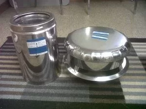

Pen: I had a bit more in there than I had hoped for and I think I know why: a sooteater comes with 6 rods and last year I didn't have the extra set of 2 rods yet. So I didn't get the last 2-3 feet of my stack. 2 years of not being swept I am sure can give a cup or so of soot (maybe I am completely wrong though..)
Now this time I made sure (using my wife as an Observer) that my sooteater made it all the way to the top and hit the underside of the cap (without knocking it off). The attached picture is of my cap. It is hard for that to block up....

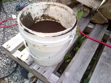

Thats looks good - what size is the bucket?

I am not sure what size the bucket is. ha. I just found an old bucket. I put it into a 5 gallon bucket afterwards and estimated it to be 2/3-1 gallon. It is super light and fluffy and easily compressed. I am still blowing black from out of my nose, cleaning it out of my ears and the crack of my....nevermind. TMI.
ALso last year I burned about 1 cord of wood that was wet. ABout 28-30% moisture content..some of the maple was even foaming. Sigh. None of that this year!

Isn't the white bucket a 5 gallon bucket? If so, it's half full which means you got 2 1/2 gallons of it.
