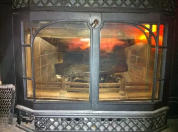

Now that I fixed my door gasket, I'm getting much better burns from the secondaries. The picture attached is from a few nights ago, where I had likely the longest burn from the fewest pieces of wood I've ever had. Picture doesn't quite do it justice, but for over an hour I had no visible flames on the logs, but a constant blue cloud hovering 6" over the wood. The heat output was amazing, and it looked like the logs were fake. I've been trying to repeat my success, and have come close, but this was my most fun to watch.

That is exciting. I am going to town today to a Home Depot and hopefully find a moisture meter.
