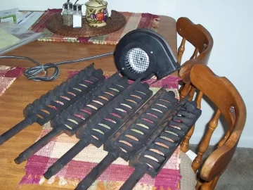

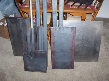

THe blower shown in the picture with the grates was a steal. THe guy said he took it apart to replace wires, couldn't figure out how to get it back together. Only cost 15 bucks, and it took me like an hour to rewire it and oil the bearings, etc. Now it runs perfect and pushes 75 cfm, which should be perfect for the stove. I have days off this week so I'm going to be taking the autocad drawings over to the fab shop so they can start making the last 5 parts I need.
Almost there!!

And the grates and blower (one grate it missing, I left it out in the car!)

So you are making progress on the Cori I From the grates it looks like a coal stove? Top laoder as well.
