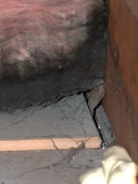

Ice dams are caused by warm air leaking from the living space into the attic. You are wasting your time and lots of money with ventilation. The solution is to find the source of the air leaks and stop them. Cellulose is better than fiberglass batts in terms of stopping air likes, but both of them are vastly inferior to spray foam. You have a messy but vital job ahead of you. First, find the air leaks, either by having an inspector with an infrared camera come over (about $300.00), or buy a good infrared thermometer (sears hadware has them), aobut $100-150. Chances are the leaks are coming from attic top plates, around light fixtures, around pipes or anywhere there is a a penetration into the attic. Next, clean the cellulose from around the leak area and shoot it with gun foam. You can get by with Great stuff, but a gun foam kit ismuch cleaner and easier to use. Replace the cellulose and you are done. Notonly with this stop your ice dams, but it will save you big dollars on heating and cooling. Here is a picture of an air leak in my house before I shot it with gun foam two weeks ago. The foam you do see in the picture is from a bathroom remodeling job I did a year before finding this gem of a leak. The insulation is black from dust-laden air moving through it. Good luck!
Not always true. Many ice dams, if fact all the ice dams in my area are caused by unequal snow melt on the roof. Many winters in my area will see over a dozen snow storms, many roofs are snow covered most of the winter. When the sun comes out, the roofs heat up and . . . if the entire roof does not all heat at the same rate, ice can form at the eaves and create massive ice dams. The snow heats up high, are freezes when it hits the cold eave.
Blaming warm air intrusion into the attic doesn't always hold true for several reasons. One is . . . many attics are used as living space and are heating full-time - yet may of those houses do NOT have ice dam problems. The new addition I built on my house hads cathedral ceilings with no attic at all and it's all heated - and gets no ice damming at all. That's because I keep the eaves warm too. But yeah, if you were able to keep your attic as cold as outside, the entire roof might stay a uniform temp. That's kind of unlikely unless you're going to leave all the attic windows open. Even it your attic stays 40 degrees - if the eaves reach a temp fo 20 below zero - you still have a huge temperature differential.
