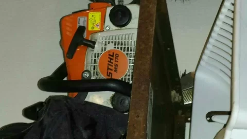

3 hours, 2.5 tanks of fuel with my MS170, cut just about a cord of tulip / yellow poplar, took one water break.

Where's the obligatory saw on the stack pic? :)
TedyOH
Oct 7, 2015
560
NE Ohio
Damn it.....in the back of the polaris!
