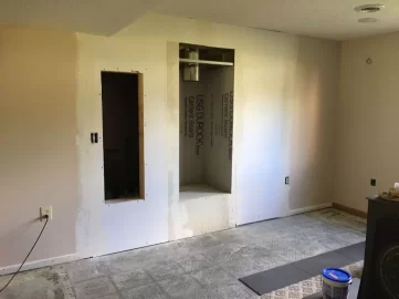

Can you describe your setup a little? I'm not understanding how a 90 out the back and then vertical would simplify things.
Here's the current setup. The reason I'm considering the rear exit is being able to just run a ~15" or so horizontal run, then 90 up toward the chimney. Versus two 45s off the top, which I may not have room for. The chimney is open to the bottom, but I do have a Tee I could use.
DVL 90 elbow says it's not recommended for rear-exit setups. I wonder why? I suppose they want you to use the Tee for the turn.

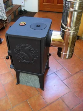

Mine is in a fireplace and vents rear, through a tee... easier to clean, no problems with draft.
Thanks branchburner. I've decided to just wait until I can get the stove positioned (need tile on the floor at the very least), then do a bunch of measuring to see which will work best. It's nice to know that your rear-exit setup works well in terms of draft!
