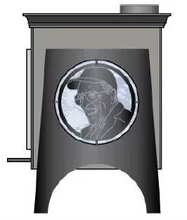

JA, that should not be a difficult decision to make. Myself, I'd go for the works and would also have the design made to our specs. Probably that would be an outdoor scene or animal, like elk, deer, caribou, etc. So while you are thinking, you might also consider what you want for a design. They could even do a portrait of you if you wish. The ideas are endless. Here are a couple just to show possibilities. They have a great artist working for them now that does some really great work and they have the machine to cut the designs really nice.
