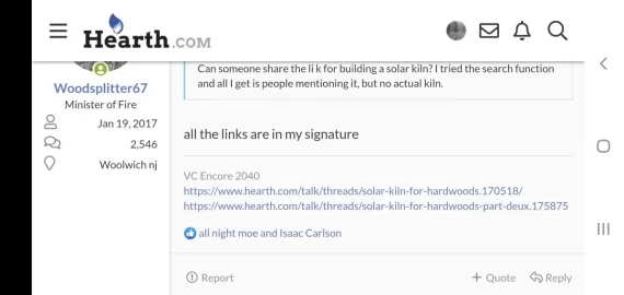

I just registered for herth.com found out by doing some other googling on my wood fireplace. I saw that someone mentioned a solar kiln and you posted it's in your signature I don't understand that. Could you please clarify. Merry Christmas thanks
.If your usi g your phone.. turn it sideways..and all the info in my signature will pop up.. see picture below

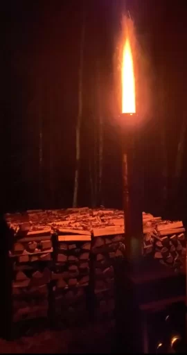

I have an outside woodstove that I’ve burned some pretty high Mc wood in. I usually use it to burn extra cardboard, or papers with bank info etc on them. But I’ve also made maple syrup on it. When I’m doing that sometimes I’ll throw in scraps from fresh split wood.
Once you get it up to temp, you can feed it whatever you wood you want and it doesn’t even smoke. As long as you feed it one or two pieces at a time.
If you load it up with cardboard, it looks like this at night :)
It has a 6’ piece of insulated chimney on it.
The stove in the house I wouldn’t put more than low 20’s Mc wood in it.

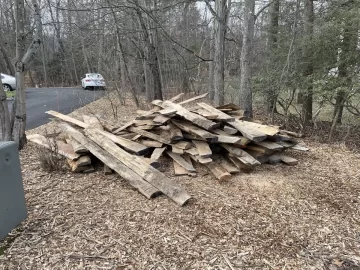

OK just picked up another 2 loads of slabwood. $80 for the wood Truck rental was 66 and gas was 11. Figured 1 got about 1.2 cords. Now just need to cut to length , check MC and stack. Some will need more time. Hoping at least half is burnable now.
