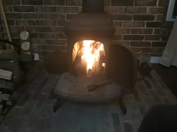

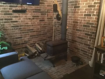

I have an Atlanta Stove Works Box 27 given to me by my father 35 years ago. I’ve used it when we lived in Nebraska: we now live in Tennessee. We recently enclosed our patio to make it an all-around room ( man cave). The stove really pops.
