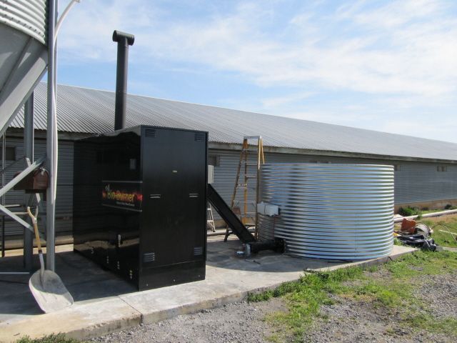

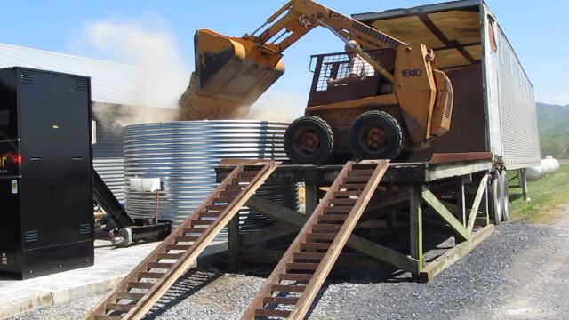

    farmerblue, have you considered using wood chips or other biomass for heat. I am using a 500,000 btu wood chip burner from LEI Products. I am not that far from you, (2 hours North) if you want to see one operate.
    Often with biomass the up front cost of admission is higher, but on the back side the cost of fuel is lower. I would be happy to talk to you if want more info.
