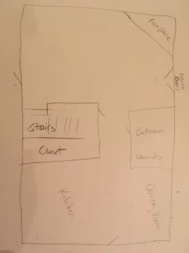

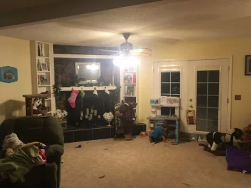

Well the house is older built in 82, we will put the stove where the fireplace currently is(I'll attach a floor plan), it is equal squad footage up and down, stairs are opposite side of the room from the fireplace, not sure about the Fireplace or through-the-roof installation, But we will find out when we take it out and open up the wall, we want to create an alcove for the stove to fit in. Don't mind the mess :) The picture of the stairs is from standing by the fireplace. There was no heating in the upstairs when the house was originally built, at some point they added 2 vents upstairs one in the master bedroom and one in the room right above the fireplace. The front upstairs bedroom has an electric wall heater in it, and the small office still has no heat to it. The room above the fireplace doesn't get very warm, but we are thinking they ran the duct behind the fireplace somehow, the duct to the master was run through the kitchen and a cabinet added to hide it.

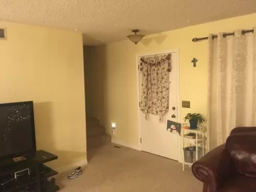

Curious enough to come to my desktop to make the pictures bigger.
Voted for the Ashford (30 implied) in your poll now that I have adequate info.
Given 1982 construction your house without upgrades will probably rate 2 or 3 stars. With triple pane glass throughout, all the air leaks around electrical receptacles fixed and waist deep blown cellulose in the attic 4 stars is likely achievable, getting a fifth star is probably not economical.
In other good news I suspect your existing fireplace is a pre fab. Is there a metal tag on it anywhere that says "heatilator"? If so the bad news is you have to take it apart from the top down, the weight of the chimney is born by the firebox. The good news is the house framing is already lined up to pass the heatilator pipe with no elbows, and it is fat pipe.
You should have no trouble installing new class A chimney in the existing run without having to modify any of the studs, joists and rafters. The one thing to be sure of is the new chimney is far enough out from the corner to meet clearance on a diagonal corner install. Actually the chimney should be fine, its the clearance between the back corners of the stove you pick and the walls you got to be careful of.
On mine (heatilator out, new class A in) I had the chimney installer push the new chimney as far out of the corner as possible given the existing openings, no framing mods, no elbows in my pipe and I have an extra inch of clearance beyond minimum at both of the back corners of both my Ashford 30 and the the similar sized non-cat that was in there before.
Your floor plan, like most any other drawn since about 1895, is not conducive to using a stove on the ground floor to heat the bedrooms upstairs. I would be looking for something that can reasonably handle 1-2k sqft without cooking you out of the first 1000.
