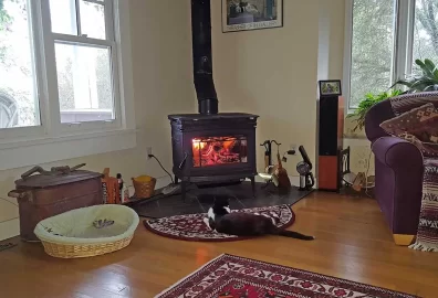

I had a 30 year old Jotul Firelight 12 in white enamel. I got it used, from the same person who originally owned my blue/black enamel Firelight 12. It looked great, other than one very nasty mess on the lid. I suspect the lid was something inflicted by the prior owner, and I saw no other signs of the finish failing.
I posted a photo of it in the "hearth from your view" thread: https://www.hearth.com/talk/threads/your-hearth-from-where-you-sit.156916/page-3#post-2116588

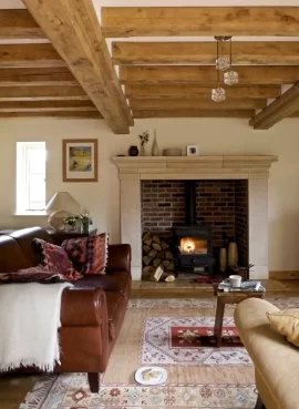

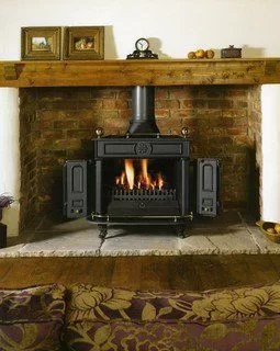

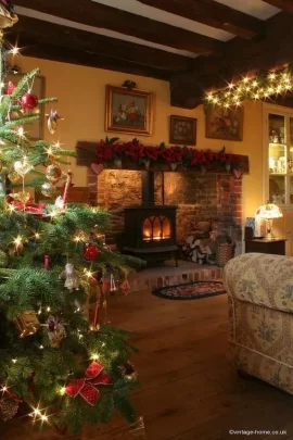

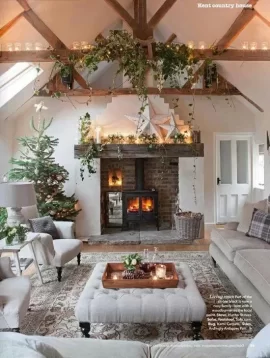

Are you going to do a stone hearth? What's it look like right now?
if you scroll up I posted a pic of it earlier...but it will be changing...can't decide between stone or brick though. It will depend on what stove I get, if I get a white one probably going with brick, but not the bright red brick, if I can find the brick that looks weathered thats what I want, if we go with black not sure....I would like something like these...but it will also depend on what happens when we pull everything out and down of the existing fireplace. The 4th pic we wouldn't be able to do as large, the 5th is a fireplace obviously but like the look of the mantel and stove and shiplap on top.
