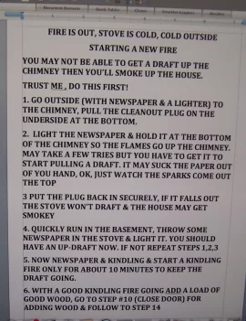

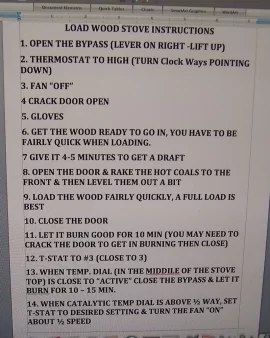

bogydave said:
Getting the draft going before you light the wood on fire is a good thing.
One morning , wife had all the smoke detectors blaring, could barely see her thru the smoke.
Showed her a few tricks. If I'm not home, she don't let the fire go out.
Now I have a few instruction sheets down by the stove
How to load
how to empty ashes
how to start a new fire with a cold stove.
Helps allot
Can you post those? That sounds like a really good ideal. ;-)

  • [Hearth.com] Importance of warming the stack
