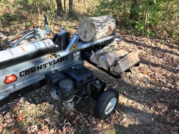

I want a cradle on the other side to hold the half split round. If you had one on the operators side, it may get in the way when your getting rounds onto the beam.

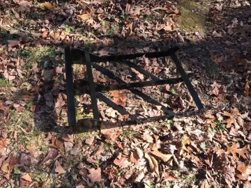

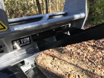

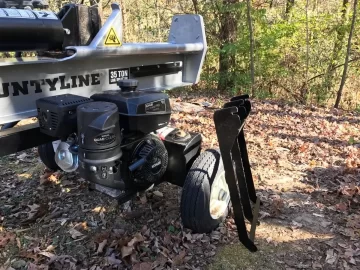

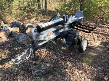

Well, I pulled the trigger and bought the one off eBay. Really well made and solid construction. I love the design that allows you to mount and unmount it within seconds. Very handy for me as I leave my splitter outside but under a custom fit cover. The cradle would make it impossible to cover if it was permanently mounted. For $100 shipped, this was well worth it. Saving my back already. I've seen the Speed Co brand cradle and this one blows it out of the water. Size and design both. Easy to install by drilling just 3 holes through the I beam. Very happy.

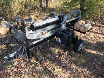

35 ton splitter! Dang! I have the 22 ton and it does everything around me. What are you splitting ? CONCRETE?

My splitter has the control high & centered so it can be worked either side, and I cabbaged up a cradle I can slip on & off either side.
I always put the cradle on the opposite side I'm working on. Otherwise it gets between me & what I'm working at & puts me further away from the beam & makes it harder to handle stuff. I just roll what will be split again, usually the bigger half, away from me onto the cradle & keep working up the other half on the beam until it's done. For me, a cradle on the side I'm standing on would be in the way, I think.
