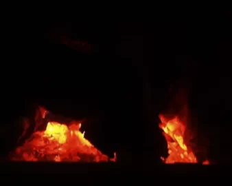

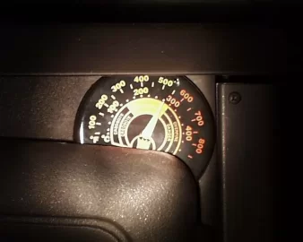

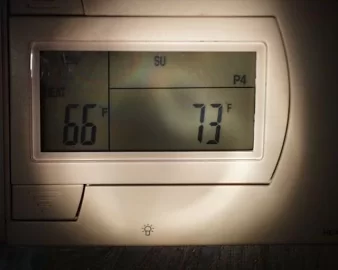

Try and take a good photo of the fire you have going(if you have a digital camera). I know ya shouldnt rely totally on a thermometer, but I find it helpful as a reference as to were your heat temp is at. tell me what size splits and how many in relation to how full the firebox is. I am new too, but I had the opposite problem, was getting way too hot. Do you have the Summits blower on hi also? automatic or manual?
Heres what I have going at the moment. Its several photos, prolly 2 posts.
I haven't figured how to control photos order so I'll describe the best I can.
One is with a flash on camera, shows the firebox lit up by the flash. So you can see what I have for splits as a reference to the heat I am getting.
The other is the same shot pretty muich just no flash to show the minimal flame but mostly hot glowing coals.
The other is the thermometer and the temp that I am getting from these coals, just under 550 degrees.
Now I don't know what kind of heating for the house you expect. My thermostat is between the living room & the kitchen. About 15-20' from the insert, and set at 66 degrees, yet insert has this area at 73 degrees. Upstairs is naturally warmer. Back of kitchen a lil bit cooler and back room I dunno 70 maybe. Not sure, no temp gauge back here. Last night I had a serious flamer going, with my air leaking door and all and it got to 78 on the thermostat. Fo me that was quite toasty in the living room. I slept with no blanket. The stove with your room sizes is not going to heat your place to 85 or 90 degrees. Might get to 80 or so near the stove. or that room maybe.
You have to be realistic, these are not furnaces, they are stoves, more meant for space heating, although many like myself use them as main heating source. My oil furnace has not fired since I installed this last weekend. 73 in here right now and not bad for 32 outside.
  • [Hearth.com] In need of help/advice?

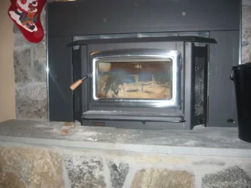

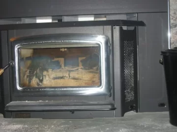

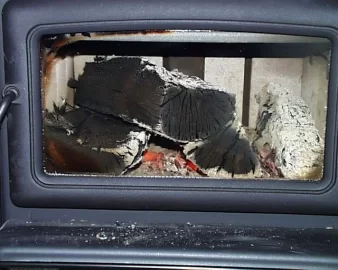

Here are the pics...Thanks Don.
You can't see the flame, I guess I need to play with the settings on the camera.

How come you ain't loading that beast front to back? Not a rule, but they are made for that. No worrys bout wood rolling out.
Whats those black pcs? paper? Do you have a real good coal bed under those pcs of wood? A good, hot coal bed is a must for getting a load to flame up & heat well.
I usually start with some small splits, when I have a couple inches of cherry coals, then I load it on.
Are you burning 24/7? or just lighting here & there.
After a couple days of continuous burning, you'll have a real nice bed of coals.
