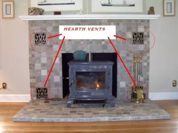

    acosta2269 , i think you and Elk post about the same time so let him catch up on your reply.
    #1 a lot of hearths have front vents , I'm not a big fireplace hearth expert but there built in for a reason.
    #2 The thing that gets me the most is that you have to keep feeding the fire and the blower fan only stays on for a short time .............you stove is cooling off fast and it shouldnt.
    #3 you said no out side air kit is installed on the "stove" but there is an air supply on the outside of the house / hearth. no chimney block off plate ..................ELK?

    Here is a hearth with vents ...........

    Roo, my vents are on the sides of the fireplace. Facing the side walls, not facing forward.
