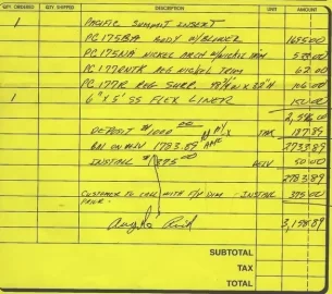

To summarize...
-No block off was installed, instead they stuffed fiberglass insulation to "stop draft and hold the pipe in place"
-A 5 foot liner was installed (6 inches wide)
-No outside air kit was connected to the insert
-Fireplace has 2 interior vents on the sides of the stone (about 5 feet from the floor). The vents are in the stone work (off to the sides (not on the plaster wall) Also has 1 exterior vent (an outside air supply?).
-From what I remember of the inside of the fireplace (how quick we forget) is that is was stone/cement. Definitely not metal (at least not on the exposed part).
-I don't know if its a pre-fab fireplace. I asked the building inspector to look it up on the building plans and the plans said "Superior/or equivalent". I'm not sure what that means. Is Superior a brand name of a Pre-Fab?
-The retailer is a family owned business. The sons of the owners did the installation.
-House was built in 2001
-I spoke to installer today and he was "SHOCKED" that I wasn't getting more heat. He said it was possible that the insulation fell down. "Unlikely, but possible". He asked to me to shut stove down and see if I feel a draft coming in from the insert when its not running. I'm letting the fire die down now and should be out by the morning so I can test for draft. He has no clue about the outside vents and ignores it everytime I bring it up.
