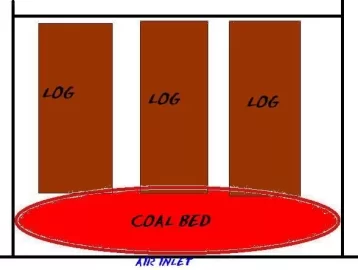

loading the wood stright in . When loading wood in sideways (east to west) the air hits the front first log and doesnt really get to the back logs for full burn.
< see pic for front to back / north to south loading >
Your PE Summit owners manual suggest loading wood front to back for proper burn.

LOL,Yeah but you have the fancy diagram ;) Besides, your the Summit pro LOL, I am a pro newb.
