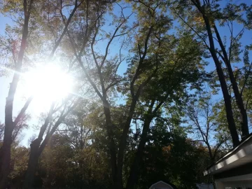

3 what are the conditions out side ( tall trees, other buildings ect)

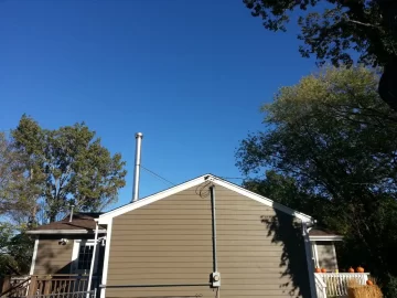

I have attached a picture of my monstrous external chimney. Also the pic of the trees is from west, but mostly in winter the leaves have fallen already. [Hearth.com] Increasing Draft [Hearth.com] Increasing Draft

Seeing that stack I am inclined to say 2&3 now. Or option 4, replace it with a less temperamental stove that is easy for both of you to operate.
That is a bunch of pipe sticking from that roof. I don't know that I would be inclined to add more. I don't really want to pick on your stove, but the 2 in1 was known to be a finicky stove. I would bet a stove replacement (I know - not a cheap solution) would make EVERYONE happier in the household. Just imagine if you could get the other half re-involved.;)
I have to agree. I would not want to add more chimney. I would probably try option 2.
I am no chimney expert. I do know the user manuals says that it "should" be installed with a double walled insulated chimney and you are stating this is a single walled chimney. That seems like an issue right there. The minimum height of the chimney is also listed as 16 feet. So if you are 15 ft...its not long enough and if it is 16 feet (from flue collar) it is just the bare minimum in height, but man that is an ungodly tall chimney already.
