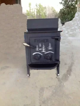

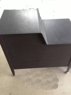

Here are two cropped pics of the Fisher stove I'm looking to buy.
When I inspect it is there anything in particular that I should look for that might indicate that I should not buy it?

Overheating will show warping or bulge on the flat sides. Not a deal breaker, but a straight stove is nice. Door should close solidly and fit the seal without lifting it to make it fit. I've seen some hinges so worn the door sags and needs shims under the hinges to center door again. Even that is easily fixable.
I went to inspect the stove today.
It has Chrome Ball feet that screw in/out to adjust the stove to level.
The door and damper caps fit flush.
There was not any wear on the door hinges that I could see.
The interior and Fire Bricks look like the stove has hardly seen any use.
It also comes with a never used 3/8" thick, 8"x15" Stainless Steel Baffle Plate.
I figure that is even better than a 5/16" baffle that has been recommended here.
I think that it is a Papa Bear, not a Mama Bear.
I measured the outside of the fire box, not the Top Plate, at 18" wide and 33" long, not counting the Ash Fender.
I wear a 32" Shirt Sleeve and I could not touch the Fire Bricks at the back of the stove.
Since I will be using it in a mountain cabin, I would rather have bigger than smaller during long, cold nights.
So we agreed on the price and it will be delivered this week-end.
Comparing it to the US Stove that I have now or the Englander that I used to have, I think I will be very happy with it.
Especially with the price I paid for it.

Sounds like Papa measurements. Papa with ash fender and pipe out the back will be 40 inches overall. The rear sheet should be 17 1/2 wide X 24 high in the Papa as well. Mama will be 16 wide X 24 high.
The other way to tell without measuring is the Mama has 5 1/2 bricks on each side compared to 6 1/2 in the Papa.
That baffle seems short to reach across a Papa. I don't think you're going to need to squeeze every bit of heat out of it anyway. Man, it's gonna be hot in there. One thing about a Fisher is the amount of heat to their size they put out. The big advantage a Mama has over Baby is holding more wood for a longer burn. My 800 sf cabin would be just right with a Baby, but with decreased load, I went with Mama. It's solid logs, so the heat loss through walls is great. But the mass heats up in time and balances out the loss. if I lived in it all the time, I would have to change it to a Baby. but for a weekend getaway, it's fine over sized bringing the cold structure up to temp.
Keep the hinges and pins greased as well as the draft cap threads and it should last your lifetime X 2.

I went to inspect the stove again today to take some more measurements.
Definitely a Papa Bear.
The width between the side Fire Bricks was 15" and too wide for the Baffle that he had cut.
Bottom line was I decided not to buy it.
