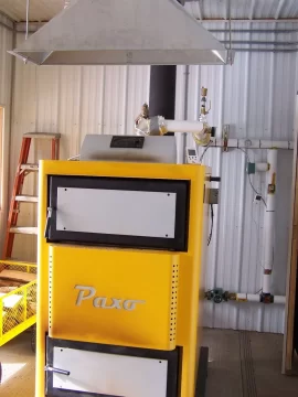

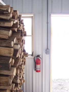

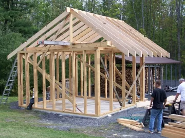

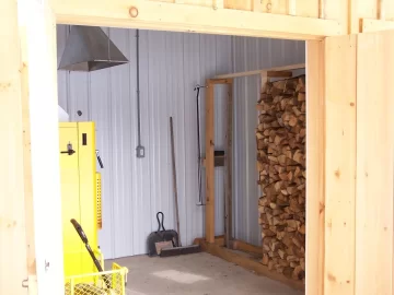

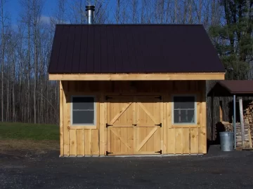

    Myself I spent 7 winters feeding a an outdoor boiler, a Woodmaster. Then switched to a Paxo 60 with 1000 gallons of thermal storage. Built a shed for that whole set up. Had my wood inside as well. Made it nice when the winds were blowing and 10 degrees out. Plus if any thing needed attention, you were inside where it was toasty warm.
    100_4634.jpg 100_4648.jpg 100_4673.jpg 100_5042.jpg 100_5211.jpg 100_5213.jpg 100_5217.jpg

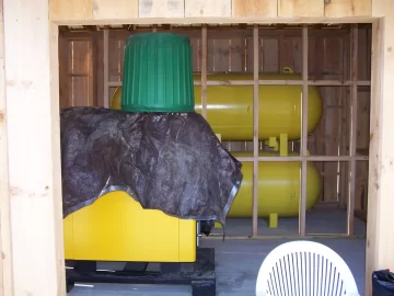

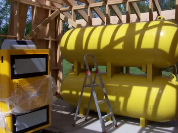

    I have since sold the place,,,,, what I can tell you is I could go 12 hours with no fire, heating a 1800 sq ft log cabin and a 1200 sq ft garage. I also had a 612 gallon STSS storage tank in my basement as well , so an easy 1600 gallons of storage. I use to let my tank temps go down to 130 degrees from 180 , but then realized, trying to heat all the refractory back up in my Paxo was a big waste of fuel. So if I did it now, I would just maintain a 10 degree differential instead. Just topping things off as needed. I think you'd use less wood in the long run. Plus if anything happened, you'd have some reserve heat. My house and garage had radiant heat plus an indirect water heater was supplied as well. I decided on the Paxo 60 because of great support from Mark at AHONA heat. He set up my storage tanks with weld rings so they were ready to go, bought it all from him. He designed my system. Man is a genius! Also he was there after the sale,,,,,, anytime I called! I believe Mark now sell Vigas boilers which he said are bullet proof.. If you haven't bought yet , I'd take a minute and talk with Mark, he's a very honest guy!!!!!!! If nothing you'll learn a lot. He designs alot of things himself as well. Had his own controller boards built which would retrofit other boilers giving you a wider range of options for controlling your boiler. Good luck,
