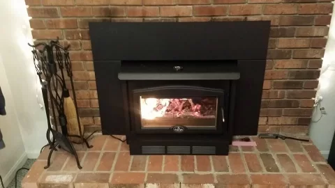

I self installed an Osburn 2400 insert in 2015, and have been VERY happy with it. 6" non insulated 25' flex liner inside a 1980's brick existing fireplace.
Heats my 2200 sq ft raised ranch very well. It is in the downstairs family room. I put a giant return vent across the room from it and run the house heater fan 24/7 when the stove is lit. The only "upgrade" I have done was to replace the high/low fan speed switch on the insert blower with a variable potentiometer. I found high to be too loud on for watching tv, and low to not move enough air. The adjustable potentiometer does the trick.
I bought it online here: www.osburnwoodstoves.com Total cost in October 2015 was $2699 including black trim, medium faceplate, blower, liner, cap, delivery, etc.

It has been a while since I have been on here. The insert installation is complete, but I am going to follow up with several posts with what I have learned from this process over the next couple of days
Purchased a Osburn 2400 including the liner, direct from the Osburn web site. The call center is located in Long Island, NY while the shipping address is in Indiana. When I called, everyone was quite helpful and pleasant. I dealt with Jack and even called to trouble shoot a couple issues that were quickly resolved and were easy to fix. Jack was pleasant an knowledgeable, always a plus, plus.
The liner and other parts, shipped separate and arrived UPS, and was sitting on my step a couple of days after placing the order. A couple more days later, I received a call from the freight company, and a delivery date was set. I requested that they call before delivery and they did, so I was able to step away from work and accept the stove, right on time. The stove arrived on a pallet and was well wrapped and externally appeared to be good condition. The driver pulled the stove into my garage with the pallet jack and placed it where requested. The order and delivery went smoothly, no concerns or complaints from me.
Getting the appropriate local paperwork was a bit more of a challenge, since Washoe County Air quality is involved. Both the individual that I spoke to several times on the phone who is responsible for wood stoves and the front counter gal, left a lot to be desired for customer service. In the end I found out the stove I had purchased does meet current air quality standards, but if I sell after 2020, I will have to remove the stove before the sale due to changes on this date from EPA. Something that would have been nice to know before the purchase, thanks!
Off to get the building permit, which was a far better experience, with pleasant and helpful staff and was even provided a phone number to call if I had any questions (my request) related to building codes.
